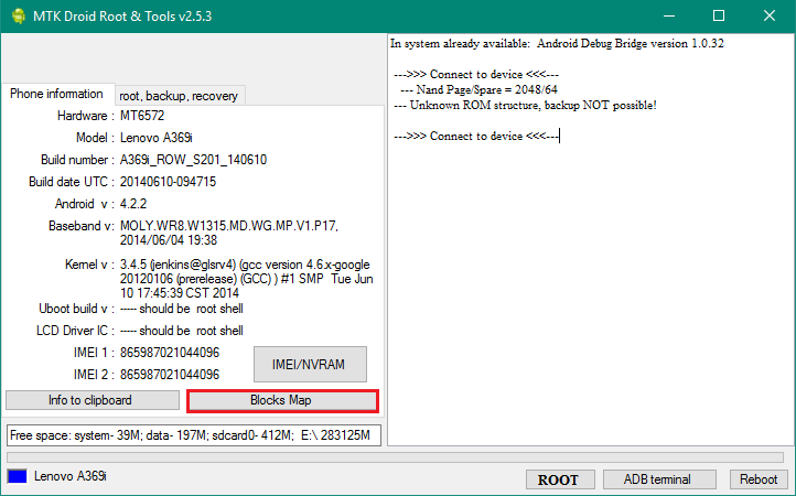

- Enable USB Debugging under Developer Options, to make the phone accessible via ADB.- If you don’t know how to do this then here is How to Enable Developer Options and How to Enable USB Debugging and OEM unlock.
- Then connect the phone using the USB cable to the PC.- When you connect the phone to the PC, MTKDroidTool will show all the information about your phone.

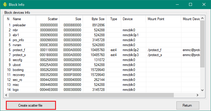

- On the below portion of the screen you will see an Blocks Map button. Click on the button
- On the next screen you have all the partition information and starting address of all the partitions.
On the bottom of the screen you see a Create scatter file button.- Click on the button to create scatter file for your Mediatek phone. - Save the file in a location which you can remember and access easily.
