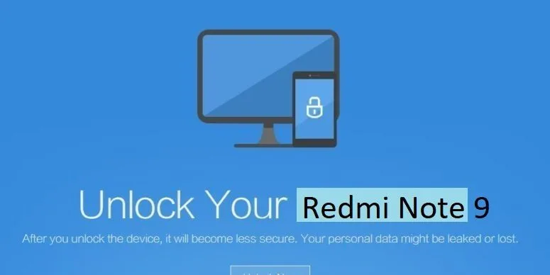

    In order to install LineageOS or TWRP or root your Redmi Note 9 you need to unlock the bootloader of your phone. In this post I am presenting a step-by-step guide to unlock bootloader of Redmi Note 9.
    unlock bootloader redmi note 9
