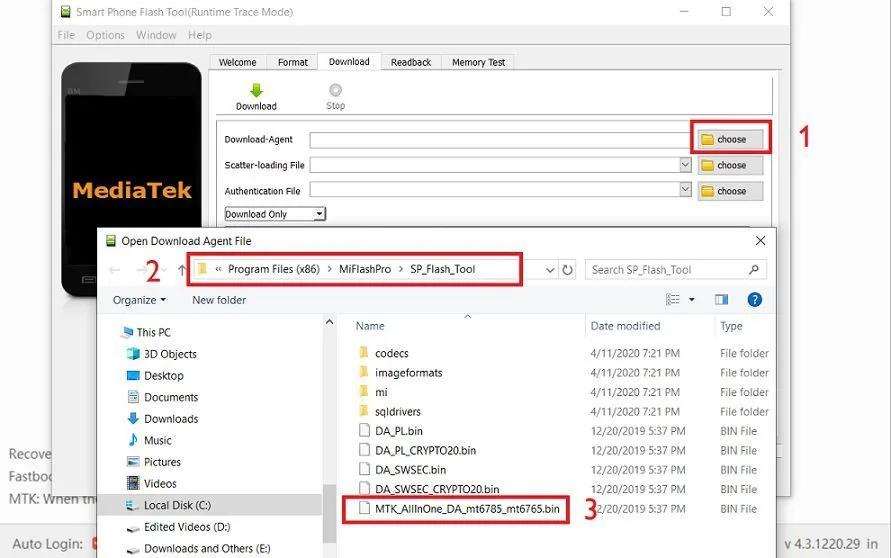

    4. Select the choose button right next to the Download-Agent box.
      Select the MTK_AllInOne_DA_mt6785_mt6765.bin from the pop up file browser that opened.
      Select Download Agent on SP Flash Tool

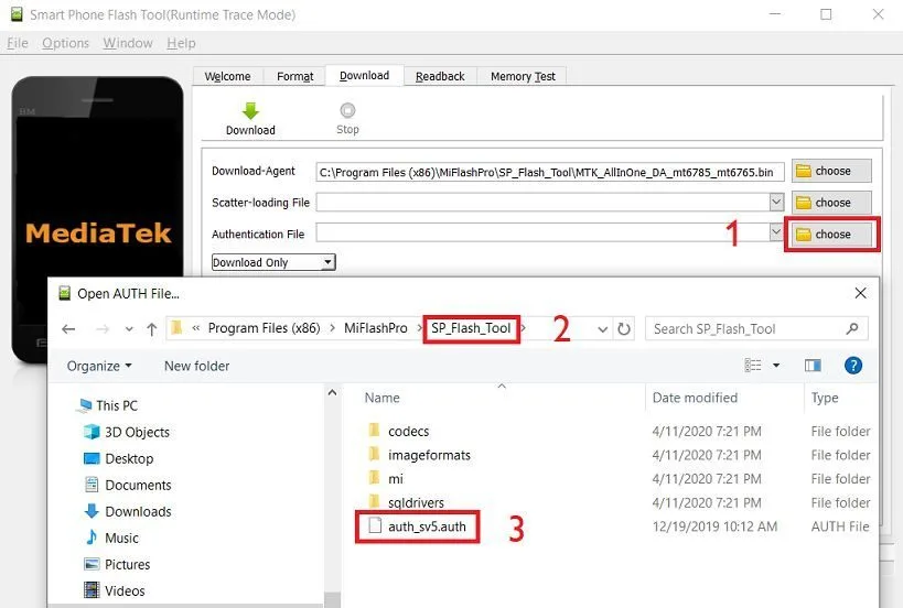

    5. Then, select the choose button right next to the Authentication File box.
      From the pop up file browser that opened, enter into the SP_Flash_Tool folder to enter and then select the auth_sv5.auth file
      Select the Authentication file on SP Flash Tool

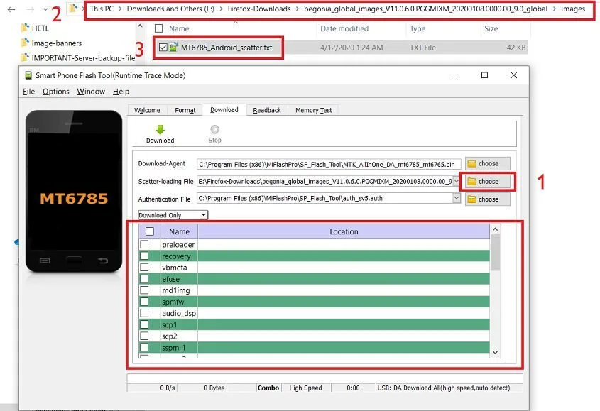

    6. Then, select the choose button right next to the Scatter-loading File box.
      Browse to the folder where you have extracted the Fastboot MIUI firmware files on your PC. Go to the images directory and then select the MT6785_Android_scatter.txt file.
      [su_note note_color="#FBF4DD" text_color="#A38C68" radius="3" class="" id=""]A scatter file keeps the partition layout information of a Mediatek chipset. It is important to select the correct scatter file for your phone's chipset only. Redmi Note Pro has the Helio G90T which is same as the MT6785.[/su_note]
      Select the MT6785 scatter file
    7. Once the scatter file is selected, the tool will automatically select all available images into respective fields.

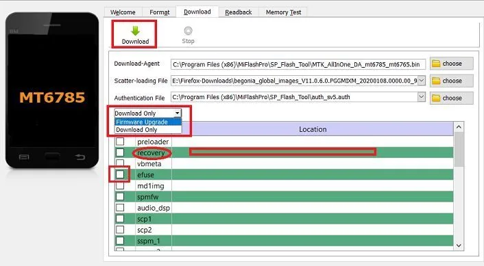

      Select firmware upgrade and download
    8. Now replcae the Download Only to Firmware Upgrade. Once selected everything click the Download button to start the firmware flashing.
