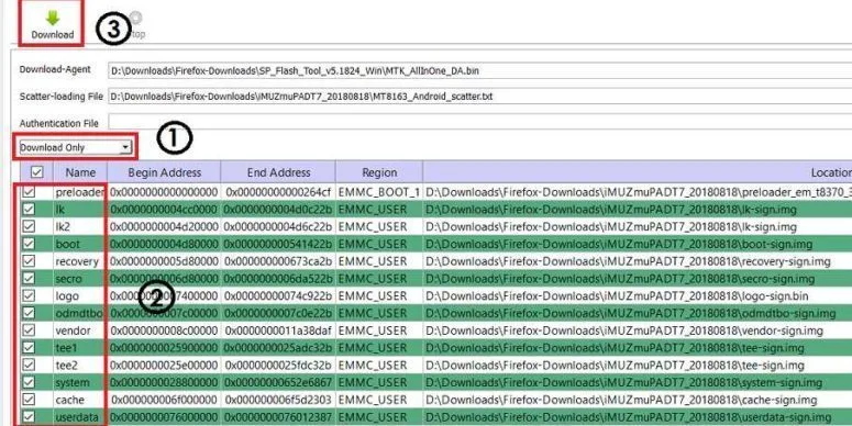

- By default the SP Flash Tool would have opened with the Download Tab open. If not then click on the Download Tab and then click on the choose button to load the Intex Elyt E8 Plus stock ROM scatter file.
[su_note note_color=”#D7E3F4″ text_color=”#728095″ radius=”3″ class=”” id=””]- You will find a scatter file with a name of somewhat MT6580_Android_scatter.txt in the Intex Elyt E8 Plus stock firmware package.
– This scatter file contains all the partition information of Intex Elyt E8 Plus Mediatek phone and which binary file to flash on a which partition and address.[/su_note] - After that a file browser will be opened to find and select the Intex Elyt E8 Plus Android 5.1 stock ROM scatter file.
Go to the Intex Elyt E8 Plus Android 5.1 stock firmware folder where you have extracted, select the Scatter file (somewhat MT6580_Android_scatter.txt) from there and click on Open. - After loading the scatter file, click on the Download button to start downloading the stock firmware to Intex Elyt E8 Plus.
[su_note note_color=”#FBF4DD” text_color=”#A38C68″ radius=”3″ class=”” id=””]Firmware download does not start just by clicking the Download button. You need to connect the phone in download mode, which we will be doing that in the later step.[/su_note]
[su_note note_color=”#D7E3F4″ text_color=”#728095″ radius=”3″ class=”” id=””]- SP Flash Tool automatically takes all the information and will show you the details of partition and binary file information. Verify all the details before start flashing the stock ROM or the stock firmware on your Mediatek phone.
– Verify the download mode before flashing (marked by number 1 in the screenshot).
– Verify which all partitions are being flashed (marked by number 2 in the screenshot). MAKE SURE THERE IS NO NVRAM OR IMEI PARTITION SELECTED HERE.[/su_note] - Now turn off your Mediatek Phone and wait for few seconds.
Then you hold both the volume up and Volume Down button and connect the phone PC using a USB cable.– You see in the SP Flash tool, it will start downloading the firmware to the Mediatek Phone automatically.
- After the stock ROM is flashed successfully on Intex Elyt E8 Plus, you will see a Download OK confirmation on SP Flash Tool.
