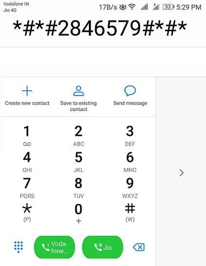

- Open your phone’s dialer and dial the following number:
*#*#2846579#*#*

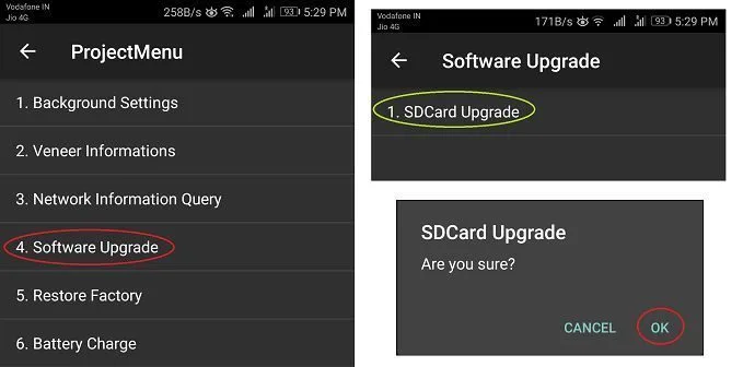

– A project menu will be opened. Follow the below instructions.
- Click on Software Upgrade > SDCard Upgrade > OK
Here is a screenshot that shows exactly what to do:
[caption id="attachment_32256" align="aligncenter" width="422"]
Dial code to enter Huawei Project Menu[/caption][caption id="attachment_32252" align="aligncenter" width="679"]
Select SDcard Download mode for Huawei Firmware Update[/caption]
You will get error message if you don’t have an SDcard or don’t have a dload directory in the root of the SDcard or don’t have enough battery charge.
If things are ok, then your Huawei or Honor phone will boot into download mode and install the stock firmware or the stock ROM kept in the SDCard root directory’s dload folder.

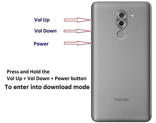

- Power Off the phone.
- Boot into download mode.
– To boot into Huawei or Honor phone’s download mode: Press and Hold the Volume Up + Volume Down + Power Button
– Release the buttons when you see the Huawei or Honor logo on screen.[caption id="attachment_32253" align="aligncenter" width="616"]
Huawei and Honor Firmware Download Mode[/caption]
If you have a valid stock firmware image on the dload directory then the EMUI download mode will start updating that firmware.
Hold back till the stock firmware is installed.That’s all.
