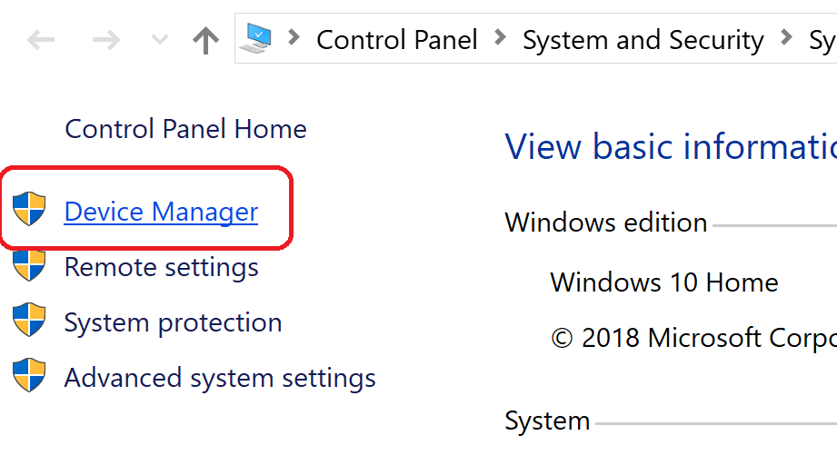

- Now, open Device Manager on your Windows PC. You can open device manager in various ways
- Click Windows button + Pause Break to open windows properties screen. Form there you click on the Device Manager on the top left side of the screen.

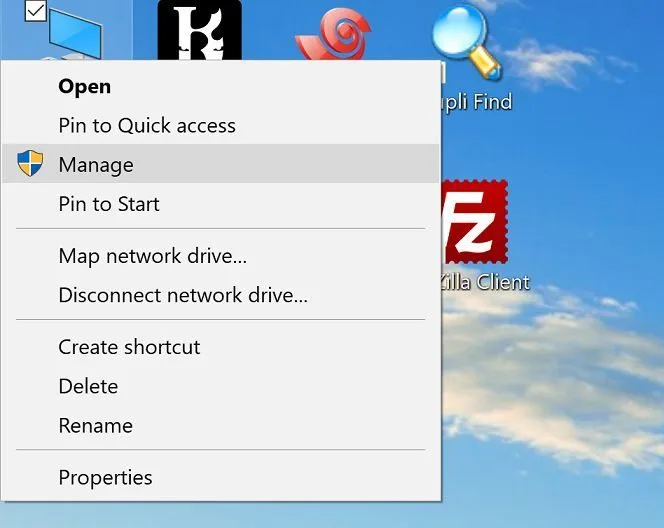

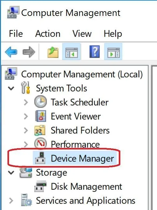

- Or Right Click on My computer then click on Manage. On the next screen that opens click on Device Manager which is on the left side.

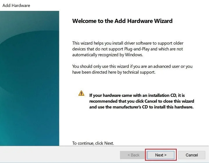

- On the Computer’s name shown on Device Manager Right Click and then select Add Legacy Hardware.
- On the next screen that appears, just click on Next.

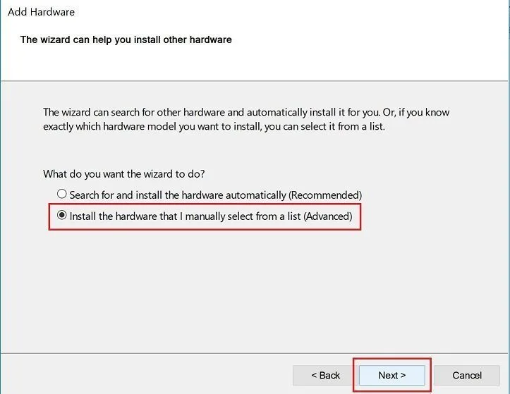

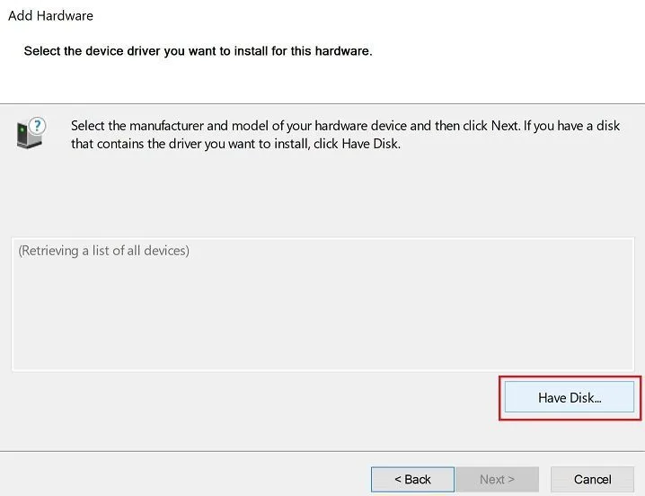

- On the next screen select the Install the hardware that I select manually from a list (Advanced) and then click on Next.

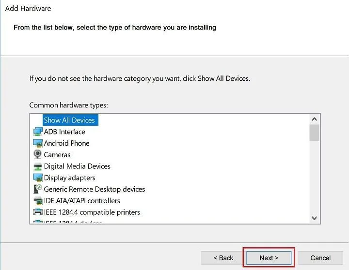

- Next screen appears with a list of devices. Just click on Next and move ahead.

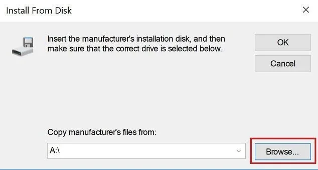

- On the next screen select Have Disk.

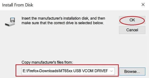

- A pop up window will appear. Click on Browse.
- Locate the Mediatek Driver folder where that you have extracted. Based on The Windows OS, select the usb2sr_*.inf file and click on Open.
[su_note note_color=”#D7E3F4″ text_color=”#728095″ radius=”3″ class=”” id=””]Replace the * with Windows OS version and architecture type, such as: Win7 (32-bit), Win764, Vista, Vista64 etc.[/su_note]
- On the next screen click on OK.

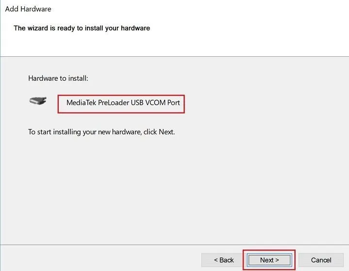

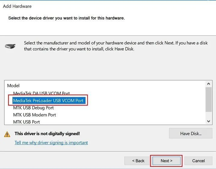

- On the next screen you will see various drivers. Select the MediaTek PreLoader USB VCOM Port to install and click Next.
- On the next screen verify which driver you are installing (in our case it is MediaTek USB VCOM driver) and then click on Next.
- On the next screen just read the status of Mediatek VCOM driver installation and click on Finish.
